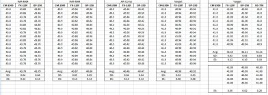

I swear my little Frankford arsenal is pretty good for what I paid for it. I've check it against my fx120i. I watch what it reads when I pull the pan as well as return it.
My little Frankford Arsenal DS-750 did pretty close to what my ChargeMaster 1500 showed in term of weight some Varget. I've never loaded any cases using it, so I don't know what that would look like in terms of velocity data. Now you've gone an done it!! :rolleyes: Just out of my curiosity, I'll have to run a little test and see how it does. . . which I expect it'll be like what I used get with my CM-1500.
