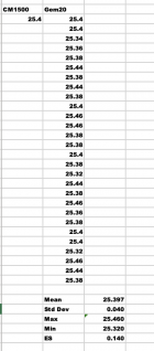

Had some time this morning to play with the Gem20 a bit. Both it and the Jennings VS-VG20 show the same weights for a variety of objects from 1.0 gr. to 117.0 gr. Tough to go wrong with either if you're looking for a nice small electronic scale. The Jennings carry case is quite a bit better if you're just tossing it into a range box...but the Gem20 box is certainly adequate.

Yesterday I weighed some bullets using a gem 20 smart weight. I bought it in the last year. excellent little scale. fast. 100% recommend.
