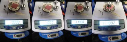

Referring to the picture below, Zero drift, Tare out drift, 10 gram fake zero, 2g added to FAKE zero, then 5g, and
5 grams plus 5mg.
If the 10.000 Fake zero changes by more than a couple counts, remove the 10 gram weight and tare the pan again.
Watching a 0.000 reading tells you nothing. Watching the 10.000 reading gives you a known starting point you can watch.

Ran a drift test on the 300g/1mg scale most of the day.
Made a crappy little video, time lapse over several minutes with 5 grams, 5g + 5mg, then 111 grams.
Seems to be a problem with playback now.
By weighing a heavy load, 100g you can check full scale factor drift.
Should be a very small percentage.
By weighting 1,2,3,4,5 g without allowing the scale to auto zero you eliminate MOST zero drift.
If scale holds weight over several minutes, with a real weight displayed, adding charge weight will be more believable. For most powder charges a 10 gram fake zero (see first post) makes reading easier.
The 5mg sensitivity weight (less than 0.1 grain) shows +/- a count or two.

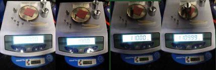

@ 6AM this morning, temperature in the kitchen was 67F.
Scale had "Drifted" to 5.003. Added 100 grams and got 104.992 grams (with 105.005grams loaded on the scale).
Zero seems to have drifted down another count and Full Scale Calibration down about 13 counts or about 0.01% .
More than I expected. Heater is on, will check again once house warms up.
EDIT: 10AM
House now at a toasty 72F, 71F under scale base.
5.007 (+2 counts) / 105.001 (-4 counts, -6 counts including zero shift)
1PM
Full scale hasn't come back. Still 6 counts low with 105.005 grams on the pan, 5.005 grams 2 counts high at 5.007. Did a three point calibration @ 100, 200, 300. Starting off with just the 100 gram weight. Getting 99.999. Added 1 gram, 100.999. Another cold (cold for us) night. Conditions not right for reloading, might as well let the scale sit.

So, here's what I did. Left scale on over night.
Measured temperature of steel base plate, bottom of scale. Overnight temperature in Kitchen=65F
Zeroed scale, add 1 gram, then add 10 gram, then 100 gram for total of 111.000.
Repeated this as kitchen warmed up during the morning. Then turned on oven and warmed up scale to a little over 80F.
Turned off oven let cool down.
Calibration factor @111g vs temperature recorded. Counts are 1 milligram each.
Zeroed for each reading.

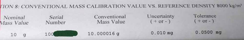

Take this line from a 10 gram ASTM Class 1 certificate.
Using this to calibrate/standardize a measurement would have to include Mass Value correction, Uncertainty of the 10 Gram standard AND the uncertainty of the measurement process.
This is where KNOWING the performance of your scale (not advertised specifications) is important.
