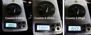

I have a scale that was advertised as 0.001 gram resolution.
Ha 0.002 in gram mode, 0.05 in grain mode, but does have 0.005 carat resolution which IS one milligram resolution.
0.02% per count @ 10 g---- 0.01% per count @10 g---- 0.032% per count @ 10 g
