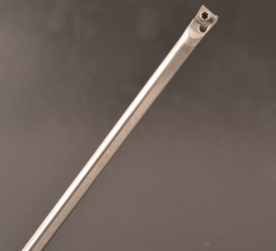

I bought one of these a couple months ago. I’ve only pre-bored one Creedmoor chamber with it but it cut nicely. What drew me to this one, other than the low cost, was the 3” length. To bore the 4-port brakes I needed a bit more reach.
Circle/Widia. I’ve been using these ever since Mike Bryant discovered them. For even smaller stuff like a PPC (or your 223) I use Micro 100 tooling.
I stumbled on to a Kennametal 3/16" carbide bar on e-bay,,,,,,, brand new, still in its original packaging. I think I paid $75 for it. It retails from MSC for over $400. Inserts are kinda' pricey, though

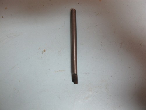

I use small solid carbide boring bars similar to shown above. You are usually only taking a few light cuts with them for this purpose.
I have been using the Widea/Circle C, 3/16 & 1/4" solid carbide boring bars, 6" with FCBI and CCBI inserts for a long time.
Use high quality inserts, they are worth it in the long run.
