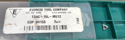

Circle Industries QCBI-375-6-5R Carbide Boring Bar w/TPCH-2205-CG5 Inserts.
Circle Industries FCBI-250-4-5R Carbide Boring Bar w/TDAB-505-CG5 Inserts. Pre-boring chambers.
Kennametal E08SDUPR2 Carbide Boring Bar w/DPGT2151HP KC5010 Inserts. Sharp high positive insert.
Kennametal SDJCRF082D Turning Holder w/DCGT2151HP KC5010 Inserts. Sharp high positive insert.
Iscar SWAPR-1414-06 Turning Holder w/WPEX060402R08 IC908 Inserts. Honed, sharp.
Iscar SER0625H16 Threading Holder. IC908 grade.
