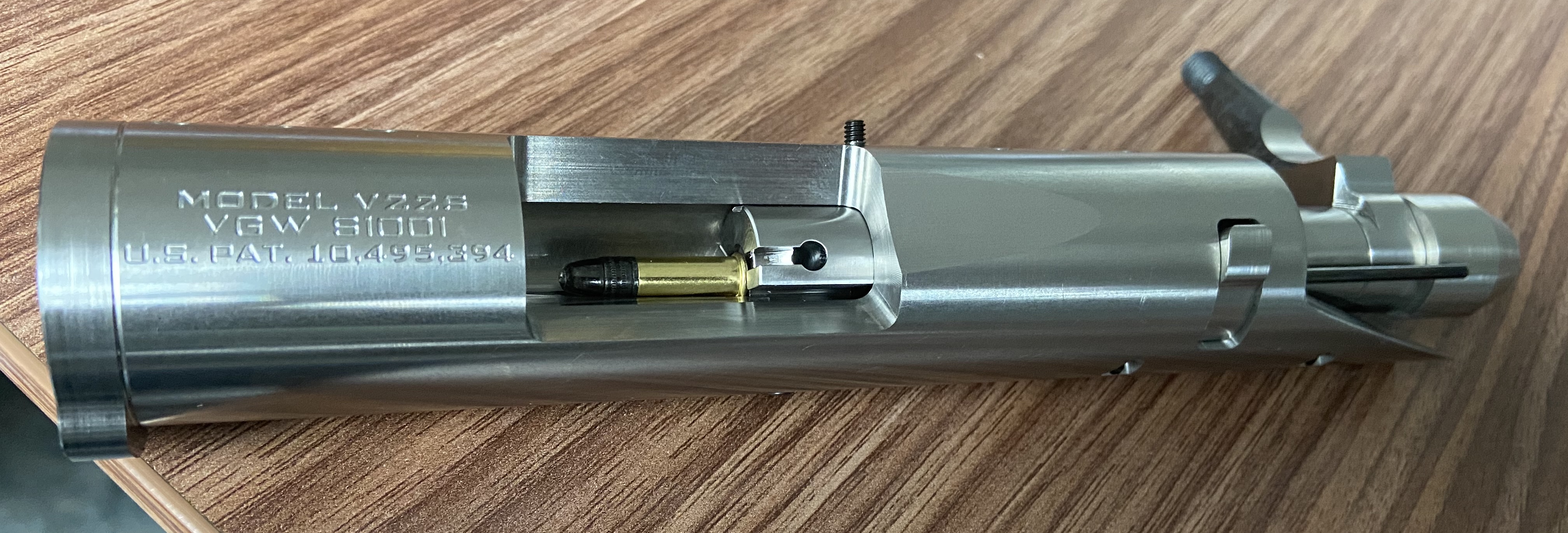

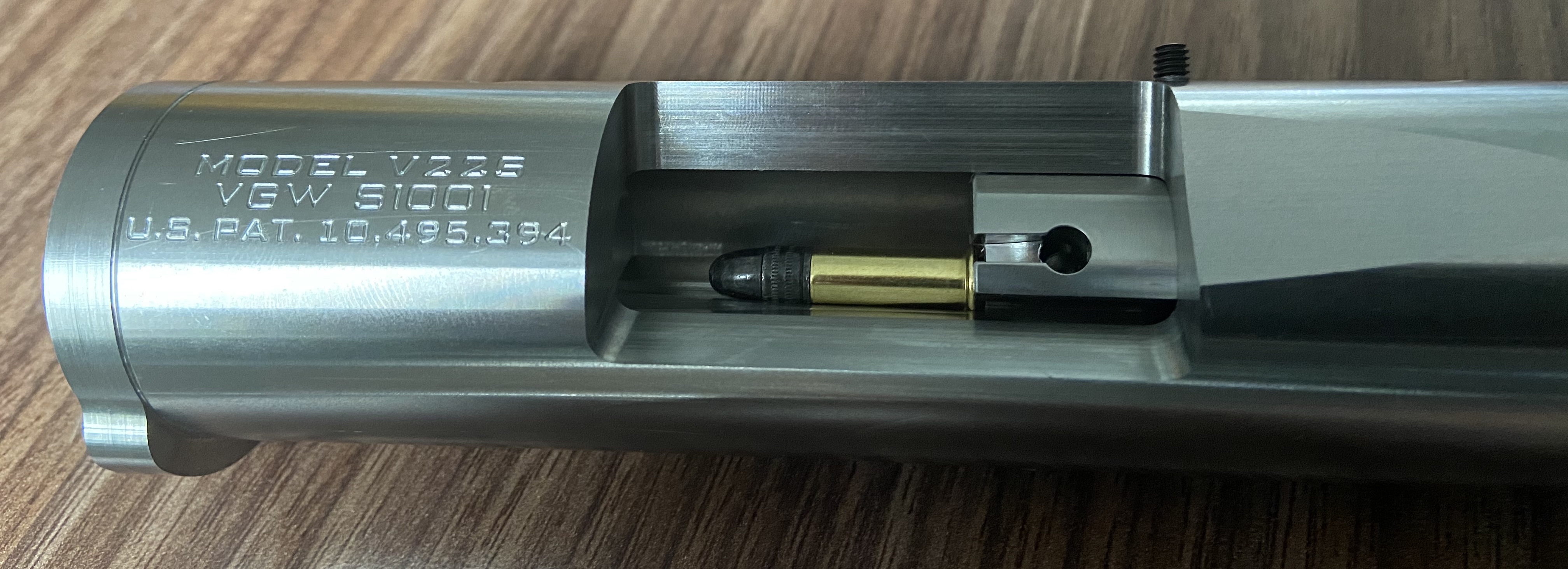

A little more to do and it's out for CVD and PVD:
