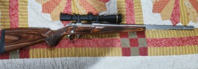

My 2nd 20 Vartarg build. Bought a used 204 Ruger barrel and re-chambered for the Vartarg. Glass bedded the action and a bit of the barrel. It doesn't like 39 gr. bullets, maybe because of the 1-12 twist, but it wants to put the Hornady 32 gr. V Max into one hole! I was in a hurry when I chambered it, as I wanted to take it on a prairie dog hunt, and didn't index the barrel markings, so at the present it looks a bit strange. :( Doesn't affect the accuracy though, that's a 5 shot 100 yard group.

That sir is one beautiful rifle!!
