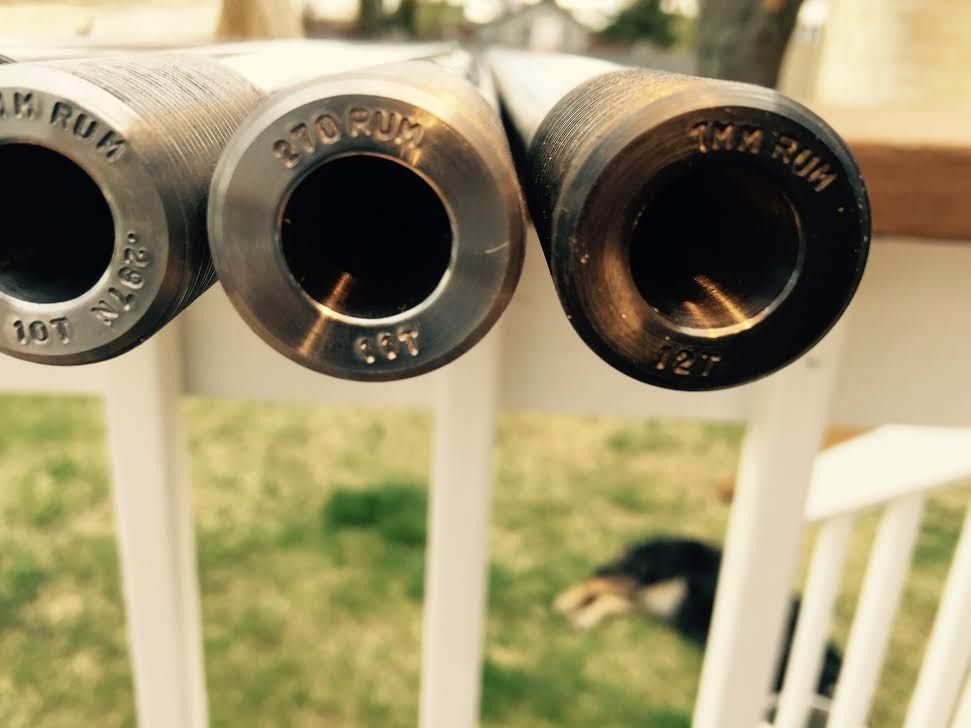

my new coyote gun im playing with is a 270wsm no throat shooting 90-110 bullets. with the popularity of the 6.8spc a whole new line of bullets have come up to try. just breaking barrel in now so no real info t report
In my 270 WSM I usually load 70gr of RL17 with the 90s, that way I can get 100 rounds from a pound of powder. My take no prisoner or fur load is 72gr to 73gr, either of these from 70 to 73 will get you a vapor trail in the right conditions. Barnes and Nosler make 85 grain versions sierra makes a 90gr HP, Speer makes 90gr and 100gr versions and Hornady makes a 110gr Vmax. Cool
