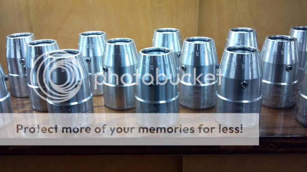

Meanwhile, here's a picture of one a few of my tuners, almost finished, and a link to my website. There's a very good read linked on my tuner page, to a research paper done at Texas A&M on particle dampening. The first tuners pictured on my site were of the first ones, made without numbers, only hash marks. The new ones are numbered for easier reference. In all honesty, the numbers are nice, but not necessary because the range of motion to stay in tune is so small, you really don't need them to keep up with adjustment. The centerfire tuners are designed to be threaded onto the barrel. The rimfire version clamps on and has an inner tube that can be cut to your PRX length. PRX is a whole other subject regarding tuning. IME, it does NOT apply to centerfire at all, but many have had great results using it in rimfire.

...and a picture of some of my centerfire tuners.
