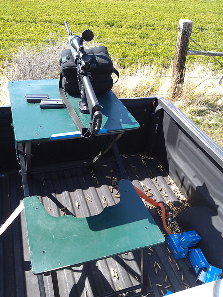

This was just a 'decent' day at 350+ rds. It can get expensive!
