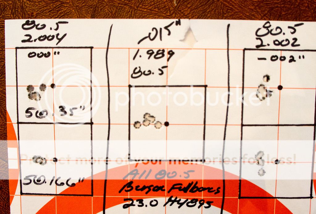

Took the .223 out to 100 yds last week to to test seating depth with 80.5 Berger Fullbores.. i am surprised how sensitve they seem to be to seating depth. 23.0 grs of H4895 used for all the groups, having been the best load so far @ 100yds. the ES/SD numbers are still so so, however. SD was 12 over 10 shots at the best seating depth, which is just on the lands
the best two groups, on the left, are at .000". the single middle group is -.015" and the two groups on the right are +.002". pretty weird that with only .002" difference, the +.002 groups had the vertical flyers. the rifle is being tested on a concrete bench with a stock/front/rear rest combo that supports free recoil shooting, so i don't think it's the Indian pulling the string here.
off to the 600 yd range on Monday to see how 23.0 H4895 load on the lands does there.
all 5 shot groups

Looks decent thus far.
FWIW, I generally don’t do “0.000”seating depth (I am assuming that means touching depth, but not sure) as at least for me, it is impossible to get that kind of accuracy in figuring out touch depth. Add to that slight differences in BTO length for the bullets (yes even Bergers), and not 100% true headspace if you are using a Hornady modified case, etc, one is almost never that precise.
Most of us start around 10 thousands off lands unless working with a VLD in which case we will be dealing with jamming. Once you finish doing initial powder weight optimization, we change seating depths at 3 thousands intervals and usually you find your best depth within 15 thousands. Making big jumps in seating depth like 15 thousands is probably too much as you might miss the best depth.

your right and i generally agree, but having tried a bunch of different seating depths both off and into the lands, the most consistent groups i have gotten were either on the lands or slightly jammed. for the reasons you mentioned, i would hope to find a seating depth that works as well not just on the lands. i did try 5 thousands off as well but it did work as well as on the lands. after i see how it goes at 600 yds, i may explore some other off the lands depths.
interesting also, i shoot the 73 gr Bergers for short range stuff, they are amazingly accurate, shooting in the .2's" and .3's" consistently and sometimes in the .1's". they also liked to be jammed slightly or on the lands.

The problem of just “on the lands” or touching is if you are just slightly off with some of the rounds, then you will have some rounds that are Jumped and others that are jammed and they have significantly different pressure/MV. This is why we either definitely jam or is far enough away to be definitely jumping.

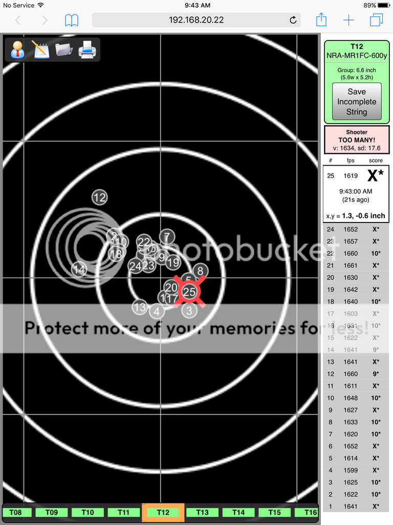

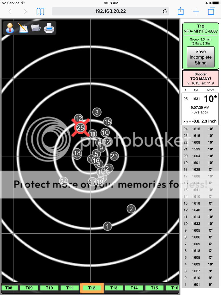

shooting on an F Class 600 yd target, i shot 5 sighters and then 45 "for record." so out of 450 points possible, i shot a total of 420 points ( 3 nine ring shots) and 23 x's. overall pretty happy with the results. for me, this rifle will be a practice F/TR rifle. for the actual competitions, i shoot a .308. i figure this is a relatively inexpensive way to practice, particularly my wind reading /correcting skills, as i am fairly new at mid and long range shooting.
finally figured out how to post the E Targets pics from my I Pad
