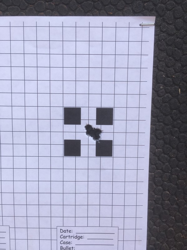

I’ve had several custom rifles made by some of the best ‘smiths around and they have all been great, but none have shot better than my Shilen DGR with Criterion prefit barrels that I bolted together in my garage. The group below is five shots from my 8” twist 22-250 light varmint shooting 75gr Amaxes at 3200 fps. The scope was dialed from zero to the upper elevation stop and back to zero between every shot. Says much for the Nightforce SHV F1 too. I also have a Criterion 6.5x47 light varmint that routinely shoots in the .4s to .5s and a Criterion .308 light varmint that groups in the .3s to .4s. When my Criterion prefits routinely group like this, I cant justify spending double the $ on a ‘smith fitted barrel.

I guess ill be the one to ask- why would you shoot a group dialing the scope to the upper stop on every shot?
