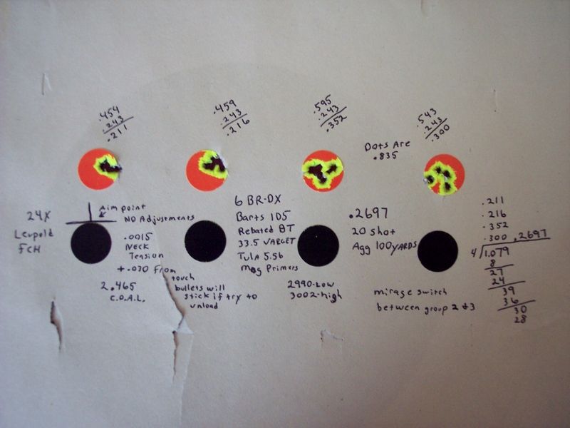

Here are 4 load development targets all starter seating depth. Just testing powder charge.
I will do 5 more next time I go foul the barrel. I just scrubbed it down from the last match I shot with it.
Johnnyi
Looks good! I look forward to seeing your agg!
