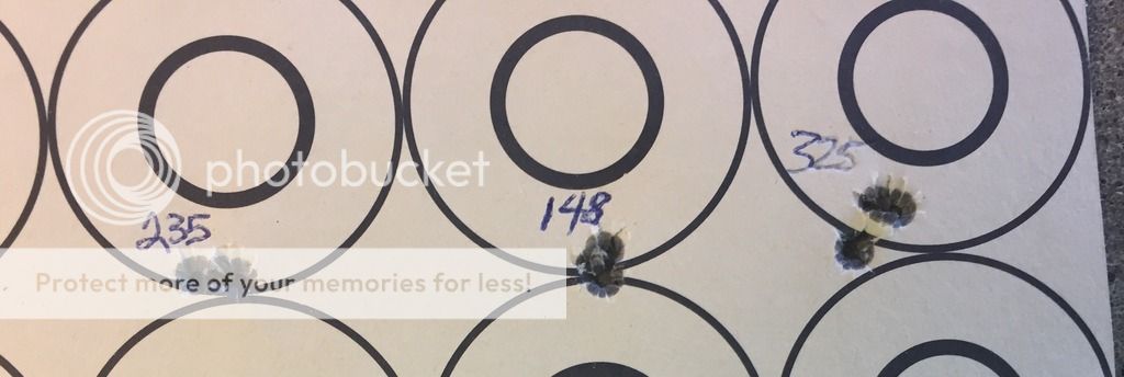

Not a dasher, but a customer sent me a picture of this 100 yard target fireforming a 6BRA, no wind flags, 5 shots each, agg was in the .2s

I've not shot the 6BRA much. Just some tuning here at the house and a 600 yard match at St Louis. Pretty rough conditions I came in 3rd in the 2 Gun and picked up 10 SOY points. The smallest group at 600 I shot that weekend was a 1.395.
Honestly the barrel started off shooting like crap! It was 30 inches long! I had Billy cut it off a couple of inches and Thread it for an Ezell tuner. I put it back on the gun and it's been a model citizen ever since. I was tuning it at 200 yards trying to get it dialed in. The picture is 3 groups of 3 shots at 200 yards with my 105 Gungnirs! I took it out to 500 yards and it would shoot .800 5 shot groups! So I don't know what brought it to life! If it was cutting off the barrel, the Ezell tuner, or the new bullets! Or the whole combination! But it will Flat hammer!
Bart
Bart
That's some fine shooting Bart! I guess I need to try some of your new 105s! Thanks for the answer and posting pictures.
