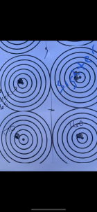

Testing Several different lots of Lapua Center-x / Midas plus and Eley match at 50 yards. Not seeing a huge difference between groups. Each lot is highlighted with a different color. May do some testing at 100 yards next. Perhaps the lots with the smallest extreme spread will have the least amount of vertical At 100. I may also try a tuner test with the center -x which I highlighted in pink. I have close to four bricks of that one.IMG_2279.jpeg
Today conditions were good so I did some testing of Madas + / center -x and eley match. All at 100 yards. Not a huge difference between the three but I lean towards the center-x groups highlighted in orange. I may take that batch next and try moving the tuner to see if I can improve the groups a bit.IMG_2282.jpeg
All the shooting above was on tuner setting 18 on a P.Q.P. tuner. Today I did a tuner test at 50 yards with the orange lot of Center-x. All 3 shot groups. I repeated some of the settings on the lower lines but the results weren’t exactly the same. I left it on tuner setting 15. I can see what looks like a sine wave as far as where the groups are forming.IMG_2284.jpeg
You have some decent groups there but personally ain't liking the 15 setting. Too much vertical in both groups. Its evident in the 1st target too.
I gave no idea where your POA was but am assuming dead center which is fine, but put 4-5 clicks up & hold same so you'r not muddying it up with each shot. Sure you can see the crosshairs in alignment with the vertical & horizontal lines, but its easier.
Just out of curiosity is this a new setup or one purchased used. And if used where did the previous owner have the tuner set?
The rifle was purchased used with about 500 rounds through the barrel. The previous owner had it on tuner setting 18.
Keith,
I took your advice and dialed up a few clicks. I shot all the same tuner settings that I shot yesterday. I cleaned the barrel prior and put three fowling shots through the barrel prior to tuner test. Perhaps three wasn’t enough because the first few groups were spread out a bit. 15 to 22 look decent. Maybe I should try the 17 setting. Pretty close to where it was set when I received it, Below is the setup i‘m using at home. The bench was built for shooting air rifles. The targets are posted on a wooden box filled with a bag and a half of rubber mulch Compressed into the box. There is a steel plate on the back side but the bullets don’t reach it. Feel free to comment as I’m new to shooting .22 long rifle.IMG_2292.jpegIMG_2289.jpeg
Mike,
1st off, I'm no tuning guru by any means. Just saw more vertical than I would like at 15 on the previous targets. Looking at this target I'd agree, 17-22 seem the best. Now see if it will repeat, multiple times to gain some confidence in them.
Having said that, a good majority of 24" straight tapered .900 barrels with either a Harrell's or Stiller tuner on them are between 160-225. By no means am I saying that lower or higher settings won't work. As a for instance I'm so dead set in my ways, (stubborn), I don't even try different settings. I start there so take it for what its worth.
I'm sure you've read a ton on tuning & if so you've read where Mike Ezell has said there will be multiple sweet spots as you go thru the range of a tuner as tune will repeat. Thats a fact. Which one your most comfortable with, that REPEATS time & time again is what your looking for.
