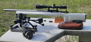

Now that the Score Nationals are out of the way, I will be spending my Range time getting ready for Tack Driver 5.
At this time, I have a choice of my new 6BRA with a 1-12 twist shooting the Barts 80 grn Dominator or the 6PPC I shot last year with my own 68 Grn BT. The simple fact is, I have got to shoot faster in the Group Matches. I can shoot my drop port 6PPC Farley, faster than the R/L/R Bat Nuevo In 6BRA.
I might try my own 68 grn double radius BT in the BRA. But the .103 throat might be a problem.
