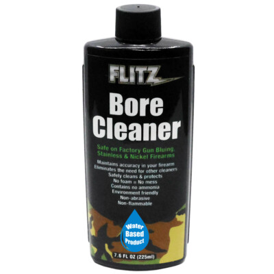

I use my old bronze brushes to apply the Flitz. I like that even better than the nylon ones. I have done barrel after barrel now. All nice and clean.
ONLY USE BRONZE CORE BRUSHES. The bristles won't hurt your barrel, but the stupid BASE of the brush sure will!!!

For the carbon ring, I'll dip the end of a mop with a concentrated solution of Lemi Shine and put it into the throat letting is soak for a time (like 15 min or so), then rotate it some. If some stubborn carbon remains, a bore bush wrapped with a patch soaked with Flitz and a few short strokes for the throat area cleans it right up.
