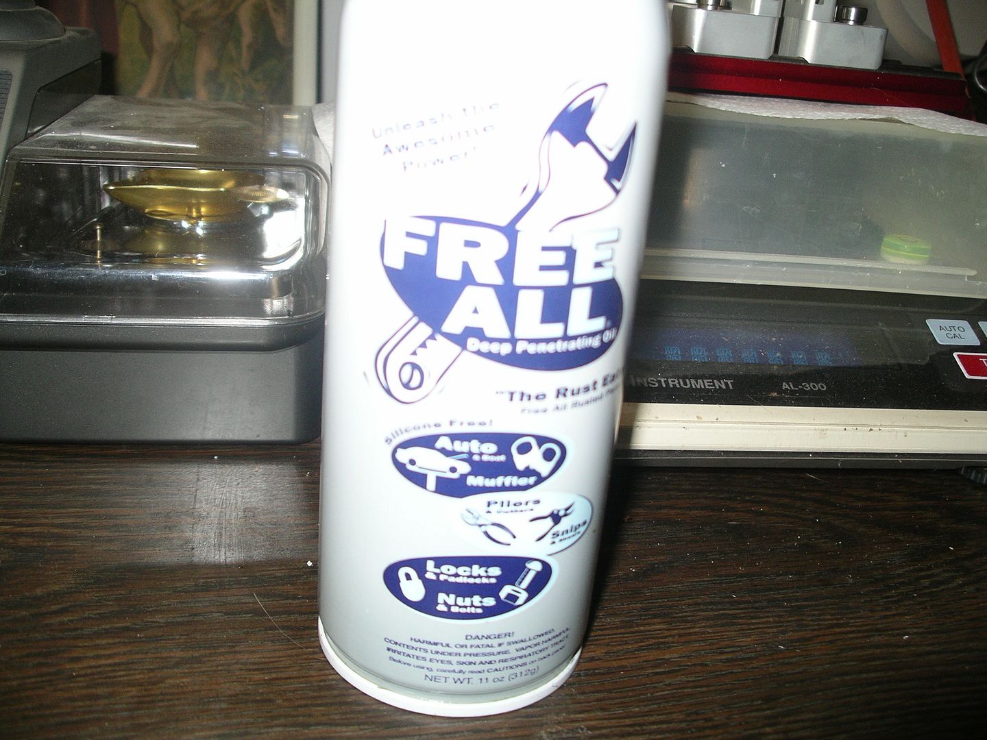

I found this year that by corking the muzzle, filling the bore with a penetrating oil that is called
[/URL]
Soaking bore for two weeks, then 20 strokes with a brush, repeat up to two more two week sessions will get the caked on carbon out to bare metal with no abrasives.
I tried other penetrating oils also:
[/URL]
I hope you don't wait till you need to ever have to "soak" your barrels for up to six weeks.
I use a hawkeye bore scope to inspect the bores, and they will come out bright and shinny soaking with the penetrating oil, then normal brushing with no abrasives. The Free All is worth it's weight in GOLD! If you ever have to try and bust loose rusted on bolts, you will learn the value of this product in spades, which is where I came up with all the other products.
