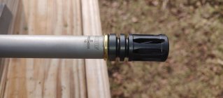

I did switch to a standard A2 bird cage because holy crap that muzzle break had me with a headache and feeling all ....weird after ten rounds. If anyone as a recommendation for a break in the sub $50 range that wont give me a headache if appropriate it lol.
