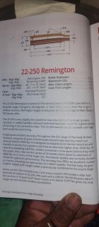

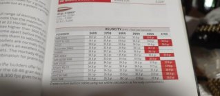

So since this thing runs faster out the gap then 95% of my lil arsenal I'm just gonna go with the book and work my way up. With AR's unusual start middle or upper lower end and work my way up due to the gas system and usually shorter barrels taking a lot of juice ..but .. again then thing is running like 3600 at the staring load so

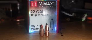

So gonna start out with gonna run the 40gr vmax one , become eveyone and there mom says 35-45 GR is where it's at for .22-250....aannnd two I have three boxes for some reason lol

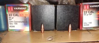

And next for a 55gr SP for anyone who wanted to see that comparison, for ... science I guess lol

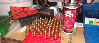

Running accurate 2460 and honestly... I usually really hate anything other than a stick powder ...but something about this I kinda like .. stuff meeters like dang water .
Not a lot of case fill though .... Wild S-D are coming I can tell already lolfull-34110-270878-img_20251006_145905646.jpg

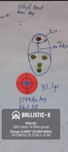

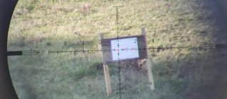

And shooting , shots where made in groups of five @100yd...no real rhythm or anything just squeezed when I felt good about the shot. After five rounds I'd left the bolt open and go load the next five got a consistent 3:30-4:30 ejection pattern and the recoil was STUPID light ! I mean make a no sense lol.
Can see the brass at the lower right here
Anyway groups
full-34110-270893-image_cropper_1759799904636.jpgfull-34110-270894-image_cropper_1759800111719.jpg
Now I don't get a velocity on the very first group because I was still getting the Chrono tuned in but with our 20" barrel we where getting roughly 250-300fps less then what the book said Soo I'd say our start load was probably 3300fps... Which I gotta say is kinda crazy that , THAT is counted as slow lol. But yeah there test rifle was a 26" bolt gun soooo
Also I did switch to smaller targets on the second set. Went for 2" orange stickers to 1" . Thought it might help a lil

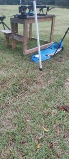

O and finally made a lil stand instead of messing with cardboard boxes lol
full-34110-270897-img_20251006_171426651.jpgfull-34110-270898-img_20251006_171433891.jpg
Also on my last two groups ..
Idk what happened with the first shots . I squeezed them off and they both just felt wrong. Like I was watching bullet impacts on all the others but those two ....idk
Anyhow I tossed them as flyers but here's what the groups look like with them....who with us information what you may lol
full-34110-270899-image_cropper_1759800189190.jpgfull-34110-270900-image_cropper_1759800262902.jpg
Guess I'll be the first one to mention this: You are doing great and glad to see you're having fun with all these projects you get into but if you really want to shoot groups (and it seems that you like shooting them), you really need more magnification on the upper end with your optics! Even a 25 power or 32 will cut your groups in half vs the 16x that you are using. 16x is fantastic for banging steel but your point of hold is likely the same size as your grouping on target with that low of a power. I'd be REALLY excited to see your results with a higher power zoomie ;)

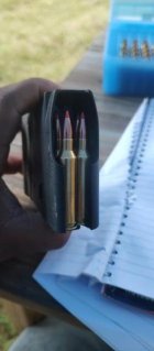

But... Also did a mag test. Most of the people with problems ( WHO ACTUALLY POSTED PICTURES) seemed to be using these straight SR25 style mags. Picked one of these up at bass pro
full-34110-271070-img_20251007_142931890.jpgfull-34110-271069-img_20251007_142924969.jpg
Thought this could be the problem because it was kinda a common issue with 6.5 Grendel and 7.62 x39 till the started making the slightly curved mags.
And as you see my PMAG is kind curved
And a little side by side
Now not the best test because I can't fully load the mag up with 10rd... because I only give five rounds left soooo.... But it's something
Also how the rounds sit
full-34110-271076-img_20251007_143146663.jpgfull-34110-271075-img_20251007_141803817.jpg
