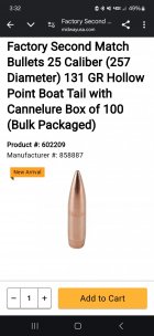

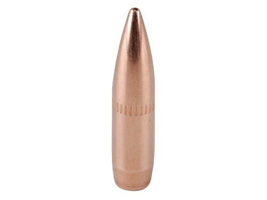

Sierra 25cal 131gr HPBT

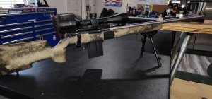

Orgin Action, Brux barrel at 24". So far I've used the older berger 110 molys, 110 Nosler accubond, and 117 Sierra GKs. All during fireforming have been sub MOA. I've tested several powders so far and settled on H4831SC. With the 110 Accubonds I'm getting 3500 on the low node and 5 shot groups around .3-.4. Had reached 3650 and started to reach pressure signs there.
Orgin Action, Brux barrel at 24". So far I've used the older berger 110 molys, 110 Nosler accubond, and 117 Sierra GMs. All during fireforming have been sub MOA. I've tested several powders so far and settled on H4831SC. With the 110 Accubonds I'm getting 3500 on the low node and 5 shot groups around .3-.4. Had reached 3650 and started to reach pressure signs there.
thank you for comments. great looking build. .3-4 is super. will improve w fine tuning. Nice.
Thanks

Not surprised at all they shoot that good with so little load development. Historically, SMK's have been about the easiest bullets to make shoot well I've ever used.

At 22 cents each if they will hold a 1moa ish group they are fine for varmints.
