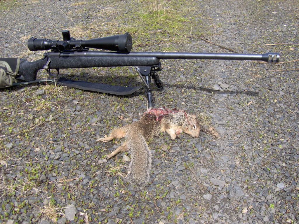

I'll jump in....new here, but will share one of my sub-caliber rodent removal tools....this particular one is my Cooper M21 MTV in 204 Ruger with a Leupold VX-3 6.5-20X LR M1 with the Varmint Hunter Reticle in Lupy Low Rings. As usual for Cooper, it shoots in the .25" range with both 32gr and the 39SBK or Nosler 40gr BT using RL-10X.
This makes my 5th .20 caliber rifle.....my 224's are starting to feel like safe queens, as the 20's seem to do it all with a lot less fuss, especially the 20 VarTarg (Less powder = more fun ;) ).

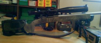

.243 Ackley Improved
Very Old Wichita Action
Hart 1 in 9 twist Fluted Barrel 26"long
Very Old McMillan Stock
Very Old Canjar trigger
6.5X20X50 Ziess Conquest
Shooting 107 SMK's @ 3238fps
Using 47.2 Gr's. of H-4831 Sc
Russian KVB-7 Primers

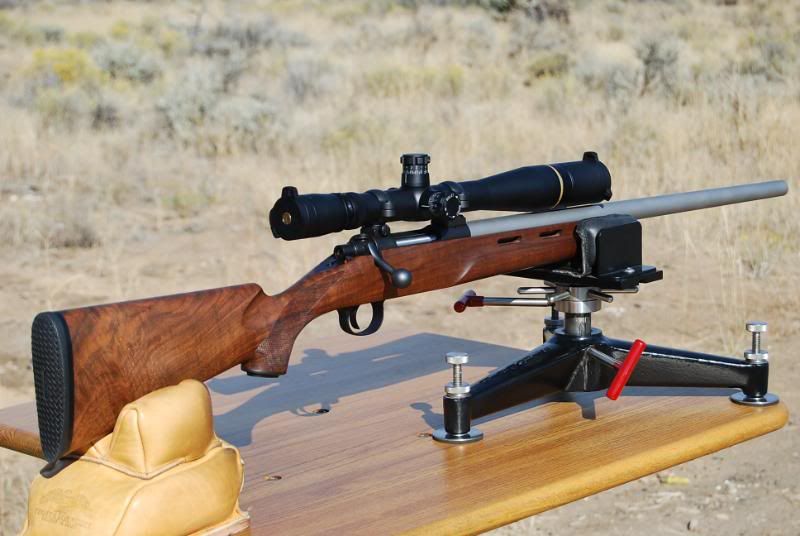

My .220 Weatherby Rocket, .257 neck set up for Norma brass and 55-65 grain bullets with zero freebore. 40X chassis with original 40X stock opened up to accept 29 inch Krieger 12 twist HV profile. Holland recoil lug, Jewell trigger set to 12 oz. and Pierce Engineering firing pin assy. NF 12-42 with NP-2DD reticle and Farrell base with Leupold Mk 4 rings. Harris standard issue bipod.
Frank
