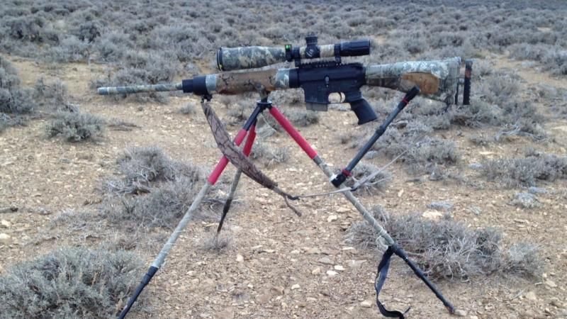

My purpose built 'any-range' coyote rig is a 6mm ART40... The semi-auto works well for running shots, quick follow ups, and when multiples come in... If they hang up at range, it's good out to about a 1000 yards. Furthest kill so far with it was 749 yards, but I really try to get them as close as possible. I shoot 105 gr AMax's at 2850 fps and 87 gr VMax's at just under 3000 fps.
