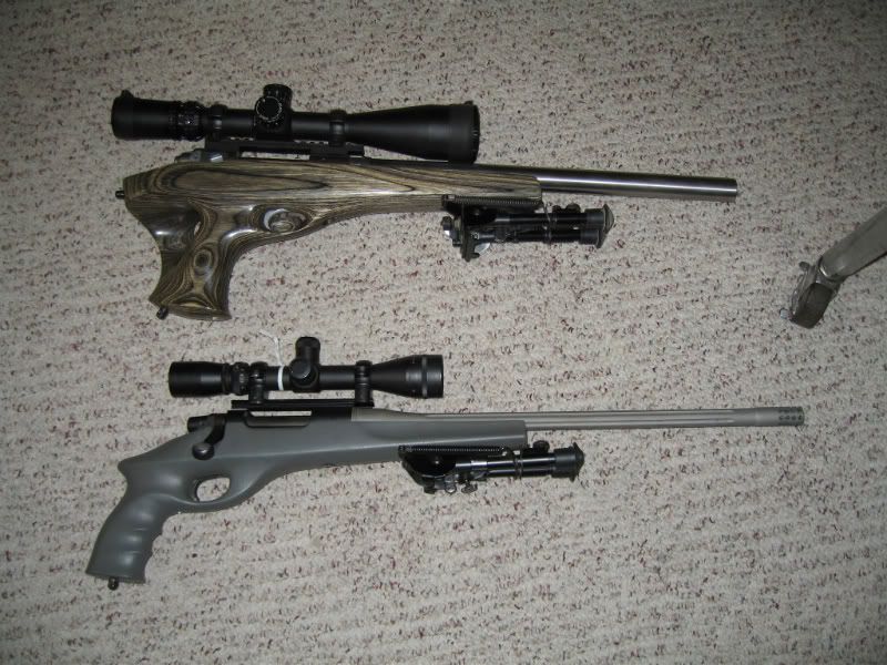

The upper gun in the pic is a Savage Super Striker 22-250 with a McGowen 8T. It shoots the 80 A-Max great, just haven't taken any dogs with it yet. may have to revisit that pistol again, do some trigger work on it, and get rid of the thumbhole part of the stock. It's a heavy gun for an SP. Holds 2 in the magazine which works just fine for my apps.
