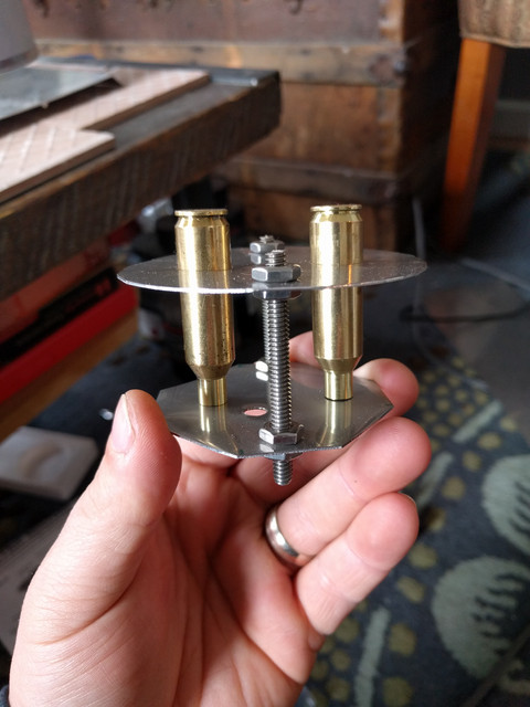

Wasn't that bad once I put my mind to it.
Not bad at all! You will want to adjust that bottom plate up some so you can increase the depth of you salt bath. The more liquid, the more it will hold the temperature stable and not cool as easily when cold brass is dipped into it. Nice job there.
Thanks. I got the pot fired up and melted some salt but before I could find a old power supply to run my thermometer I had let the salt cool back down. I want to get it back up to temp tonight and get the level situated as well as adjust my plates needed. I have enough stainless to make 2-3 different holders. I want more bits and need better drill bits to do 2-3 more.

Alright I raised it up and added more salt. I am about 3/4" from the top of the melter with my salt level. It was fast and easy, put a phone metronome on and timed the first few for six seconds. I was going off the original post that I read about this from 6.5creedmoor. I upped mine to 7 seconds as there's just more brass on my SAUM cases. I got good looking annealed cases it seems. The anneal soaked just past the shoulder and the body stayed fine with the case head cool to the touch (I did it bare handed after a few). So easy and controllable.
So what kind of time do you keep a .50BMG case in there? I bet that thing soaks up some heat as you go. I did about 150 cases my first fo around. Some are .300SAUM destined for neck down to 7mm.
I don't have any experience with larger cases, I am doing the 6.5 Creedmoor for 5.5 to 6 seconds at around 530-540C. I got the level of salt about half way up the shoulder of the brass. Are you seeing any large drop in temperature when the brass goes in? There is a video on you tube showing a 50 BMG being done. Appears to be about 6 seconds of dip time being used with only a single piece of brass.
I run my salt bath at 550C and have found 8 seconds to be the proper time for my 50 BMG cases. My necks are all turned to a .020" thickness to assure adequate clearance in my .554 throat. On my next annealing session, I will also try using a infrared thermometer to see if I can get an actual temp reading of the brass right after it's removed from the salt bath.
