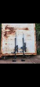

I wanted to share my recent hunting rifle build. I believe I made a ultimate classic modern 6BR rifle.
Remington 700 action
22" Shilen 5.5 contour 1:10 twist threaded 5/8x24
Fully re finish of a 70s era bdl stock
Timney HIT trigger
Leupold v3HD 6.5-20x50
I wanted to build a classic bdl rifle using the great 6br cartridge. I completely redone a bdl stock, that took a while. My local gunsmith chambered me up this shilen barrel with a no turn ptg reamer. .60 thousand freebore. Cut to 22" and threaded for my suppressor. I followed Mike Bryant's instructions on the internal box mag, it feeds flawlessly. Bedded the rifle with marine tex. I am using alpha brass. With only 30 rounds down the tube things are looking promising using 95gr bib bullets over varget and 90gr eldx over varget. This rifle is going to be a lot of fun to hunt with. Let me know what you think. What is your go to hunting load for the 6br

Are your running suppressed loads with the suppressor? Iv never loaded for using a suppressor. Just guessing, are you at 27grains or less?
No I'm running 30.7gr of varget with these 90gr eldx. To me my suppressor makes it tolerable to shoot without ear pro. With this and my Dasher the suppressor really does a great job with that. I have never loaded a slower load to run suppressed.
This one is what I’ve been using when hunting around the house. It was a couple of years in the works. Got 5% off due the scratches on the stock, (was a 6.5 CM) had the firing pin bushed, 10T Pac Nor barrel, and Cerakote. Found a decent load quickly and stopped for now. Berger 87 VLDH, 26.4 LT-32, Lapua cases. Shoots about a half inch at 160, I shouldn’t have more than 90 here around the house. 45-50 is more likely. I swapped the 4.5-14 in favor of the 1-4. The 1-4 has an illuminated dot crosshair.
