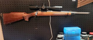

I wanted to share my recent hunting rifle build. I believe I made a ultimate classic modern 6BR rifle.
Remington 700 action
22" Shilen 5.5 contour 1:10 twist threaded 5/8x24
Fully re finish of a 70s era bdl stock
Timney HIT trigger
Leupold v3HD 6.5-20x50
I wanted to build a classic bdl rifle using the great 6br cartridge. I completely redone a bdl stock, that took a while. My local gunsmith chambered me up this shilen barrel with a no turn ptg reamer. .60 thousand freebore. Cut to 22" and threaded for my suppressor. I followed Mike Bryant's instructions on the internal box mag, it feeds flawlessly. Bedded the rifle with marine tex. I am using alpha brass. With only 30 rounds down the tube things are looking promising using 95gr bib bullets over varget and 90gr eldx over varget. This rifle is going to be a lot of fun to hunt with. Let me know what you think. What is your go to hunting load for the 6br
Classic.
I have always wanted to build one like that. You had me right up till the silencer. I like em. Just lost me on the classic thing.
I ended up chambering the 6XC over 6BR for a hunting Rifle and have been happy enough to abandon the 6BR idea.
But nice build, nice Rifle.
It cuts the classic look but once you shoot suppressed their is no other way in my opinion. Makes shooting that much more enjoyable.
Great hunting build. I love the BDL stock for a hunting rig. I have put 3 together in my life, al in .280. Have fun.
Remembering this thread. I had a few extra parts laying around and threw this one together 700 18" remage 6.5 creedmoor 1-8 twist in a very classic stock. Topped with a 10x swfa
I still LOVE those old classic stocks!!! I think that looks amazing. If I were going to deer hunt I would have an old classic Rem 700. I found one at the gun show in 243, I should have bought it. But I really don't deer hunt. :)
