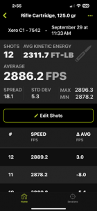

Finally got everything together for a range session today. 125gr Sierra Gamechangers, 7BR brass necked up and turned, N130 powder. Super windy day at range so no flags as I didnt want to go chasing them across the range!!
At the end of the day I achieved 2792 fps with a case full of N130 and no signs of excess pressure on the case and no grumblings from the rifle bolt. For kicks I shot the same bullets out of my Hunter gun 30BR 15 twist at around 2882 fps and again with a case full of N130...and again no pressure signs on case no grumblings from the bolt. Point of trying Hunter gun was to see if the throating was enough to handle the longer 125gr bullets without running past the neck shoulder junction for a "fairly standard" 30BR chamber more designed for lighter 112s, 115s bullets. Mission accomplished there. Both rifles shot great for today's no flag conditions. I will find my target and post groups. The fun continues!! :D

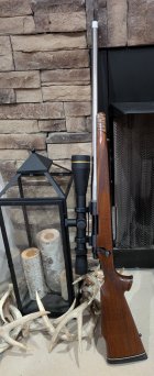

My Smith has got my barrel done and this weekend I bedded the BDL stock and got the scope mounted. Fire formed 4 piece of brass and got initial velocities with the 125 noslers.
Rifle build list review:
Remington factory Short Action
Shieln 15 twist #5 contour 22" threaded 5/8x24
Remington BDL stock
Alpha 6br brass necked up to 30
In the brass photo top piece is just necked up 6b bottom piece is fire formed.
33gr of Lt30 gave me a velocity of 2830
I believe a fire formed case will hold one more gr of powder. Can wait to get to the range and see how it shoots. Brass has been sent to harrel's to get a die made
