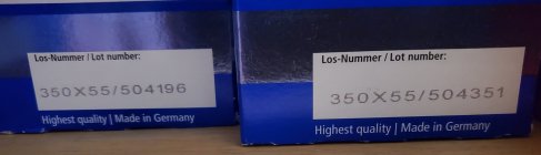

That's what I have understood as well, but these two lots of Biathlon Xtreme have me scratching my head over it. Both bought last summer, one from Creedmoor, one from Mile High.
never seen that before, hmm maybe that is the way to quickly tell it from regular Biathlon..
