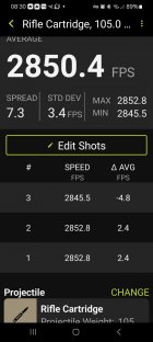

I had the same issues after an update (3.27 to 3.30) this past Sunday. Garmin worked flawlessly up to that point, had never missed a shot. Immediately after the update it started missing shots...anywhere from 20% to 40%.
After the first update the Garmin showed version 3.30, but my ShotView app still showed 3.27. Last night I updated to 3.32, but the app still shows "Version 3.27 - Up to date". I also had to use Garmin Express to get the update on the chronograph. No mater what I tried it would not update the App in order to update the unit.

Where does it show on the Garmin unit itself on what version it’s on? Thanks.
I think I finally found it on my Garmin unit under Settngs then About, this gives unit ID. It has on that SW: 3.32, so maybe it did update the unit and the App still shows 3.27.
Agreed. I think the unit itself has updated to the latest version, but it doesn't show on the app...just seems strange that they didn't link up or pair up like they're supposedly supposed to. My app is two versions behind as it still shows 3.27 whereas the unit itself has gone from 3.27 to 3.30 where things went to S&$T and now it's up to the latest 3.32.
