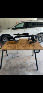

This is fairly easy to accomplish with those leg brackets sold here by Lonnie. Contrary to common belief I am able to get 4 legs to sit evenly by leaving one of them adjustable. Works on concrete and ground very well.
