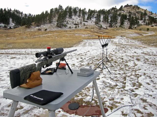

I like to shoot off my Protektor rear rest with sandbags as a front rest for initial load development then to the bipod once I get the good load.
This one works for me. Roll it up in my utility trailer and I can take it from the home range to the farm for longer shots.

The big wheels make it easier to move it across the rough ground and snow. It's on my 50-120yrd home range.
