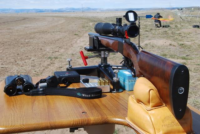

I modified this particular bench before they offered the additional support bracket. Now they offer it though as well as multiple leg holes which help on uneven ground. I did make the oak board for the top which allows me to put a slight load in my bipod. I "personally" prefer a accu-tac bipod over a front rest in prairie dog town. Many of the towns I shoot are more rolling type terrain and I am constantly needing to make vertical adjustments as I spin around from dog to dog. I also keep two heights of rear bags which I can quickly change in and out as well.

The butcher block may appear to be over-kill but when bearing weight on unsupported 3/4" plywood doubled top one can see flex while looking in the scope.
We used 1" edge-glued white oak for our benches and mine is still going strong since 1997. Care must be used to not expose it to the weather or it'll warp, but most guys take good care of their shooting gear so not usually an issue. A spray coating of clear matte Verathane makes it good to go if it rains in the field and can be easily wiped off with a towel.
As Bill noted above, the butcher block oak is not overkill at all, as I've never noticed any deflection of the bench top in any regard over the years.
