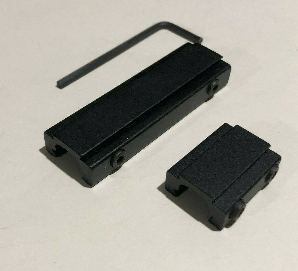

https://www.ebay.com/itm/334198181730?epid=727397744&hash=item4dcfc38f62:g:cU8AAOSwBtNfUPQH
Here are pics of a possible option on the FWB adapter I found on EBAY and the FWB dovetails

What you found are called riser blocks and are used for raising the front and rear metallic sights for better head / eye position.
They are for 11mm dovetails on FWB and many other EU rifles.

Those aren't adaptors for mounting standard rings/sights on the rail. Those are raiser blocks, wedges to lift up the aperture sights: big block under the rearsight, small block under the front. 3P (and prone only) shooters use so they don't strainer cramp their neck to aim.

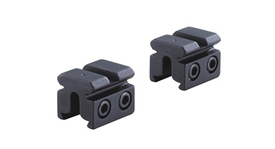

The BKL dovetail to Weaver adapters (500 series)should work as they can expand the clamping width by removing the clamping screws and screwing them into the provided threaded holes. by tightening the screws they will push the clamping slot further apart and make it wider. I would think making them 1-mm (0.039) wider would be no problem.
