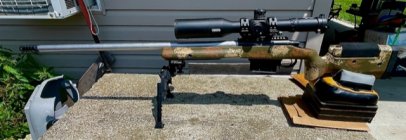

My new Left hand F-TR .308 Bighorn T-L3, Manners T-6 stock, Bartlein
30 inch Heavy Palma with 1-9 left twist, SEB Joypod X, Nightforce Comp scope, Tigger Tech rem 700 left hand Diamond Trigger at 8 oz, 100 yard zero

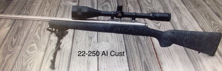

This is a trued and squared Rem 700 SA 22-250 Ackley, chrome molly action, threads cut .010 over, .250 recoil llug, run on a surface grinder, 100% lugs contact, custom bolt handle, hard chromed satin finish by Bob Coogan at Accurate Plating, Kiplinger single set 4oz trigger, the barrel is a 26" SS fluted Lothar Walther air gauge, computer lapped, premium Magnum Sporter set up for the 80 grain SMKs. The stock has an aluminum action block with the action and bottom metal 100% glass bedded, barrel is free floated. Harris Bipod.
Walking crow, pulling up new corn plants, 454 yards laser ranged. Scope set is for actual click adjustments to 800 in 25 yard increments from 200 zero.

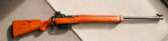

I am a pushover for those rifles.
Recently aquired this lovely 1960's British target rifle, an Enfield Envoy. The same rifle was fitted with a Pecar 3.5-10 for the UK Police as the "Enfield Enforcer" and used with a 6x Kahles scope by the Canadian military. It's in 308, with a magazine made by Sterling.

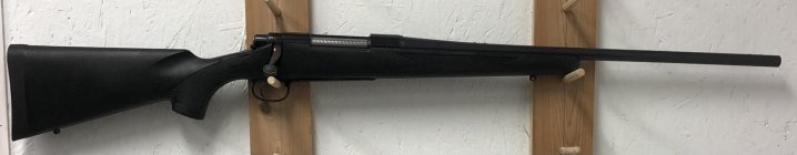

Never saw a barrel shaped like that, stealthy. How's it shoot and who made it?
It's a Remington VTR in 308. It's basically a 700 action on a bull barrel with the sides milled. I have read some have issues with it and the barrel design is faulty but when I shove a 168 A-Max pushed by 43gr of Varget into it I have absolutely no complaints! I added the Magpul Hunter stock.
