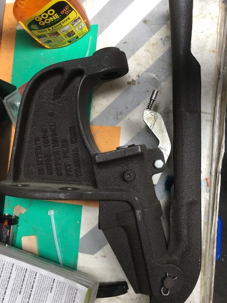

I just want to say thanks to everyone that put out the effort to help me figure this whole thing out! I figured out what the problem was, unfortunately breaking my press in the process. When there was nothing in the vise, there was no gap at the top of the stroke, but when it had a case in it the gap was always there. Finally, I pulled hard enough to snap the press, but that case chambered perfectly when I tried it in my rifle. I was really trying not to break it because the buddy I bought it from passed away earlier this year, so that's why I was being kind of easy on it. Thanks for jumping in here to try and help me figure it out guys!

Sorry you broke the press Mark but glad you figured it out I’m guessing it was sprung anyway since your die was bottomed out and still not hitting. I have a couple Lee hand presses and there aluminum as well there dedicated 22 hornet one has the sizing dir one has the expander die and the other the seating die there not much but good enough for what I use them for. I think any good cast iron o style or similar press will do you fine and you won’t have to break the bank doing it, I really like my Redding presses and my Rockchuckers but Lee’s big cast iron press is good as well

I have a Lee C press that I only use for depriming while watching TV - I don't trust it for sizing. A modern press like the Rockchucker or Lyman Victory will do well for you. I like the Hornady Lock-N-Load bushing system for quick die changes, so the Hornady Classic or the Rockchucker would be my recommendation; either can use the Hornady bushings.

A good friend of mine has exactly the same press. It is made of aluminum and will bend if too much stress is put on it. If it continues to bend back and forth while you are trying to resize brass, it will eventually break.
You would have had to get or try a different press to find out yours was not performing as it should. But you figured it out with what you have, and that is often important in reloading.
Invest in a better press and as time goes on, you will find it will be money well spent.
