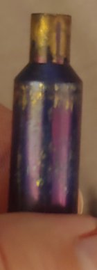

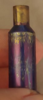

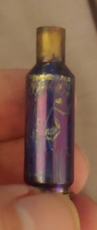

Get a sharpie, ink the whole case.
Index mark only on the case head
Insert it in the chamber with your finger.
Remove the case
There will be a rub mark on the case where it hits and likely an ink mark in the chamber. The index mark will help you locate where to look in the chamber.
If you push it in firm, tap it out with a cleaning rod.
Hard to tell if the scuff marks on your brass is from the die or the chamber, but it might be as simple as not enough lube if it's from the die and that may be why it's not sizing correctly.
If its from the chamber, it's a stout load.
Remove the case
Remove the case
The pic with the "squiggle" was at 12 o'clock. The others I turned clockwise from 12 o'clock and the scratching around the shoulder was uniform all the way around
