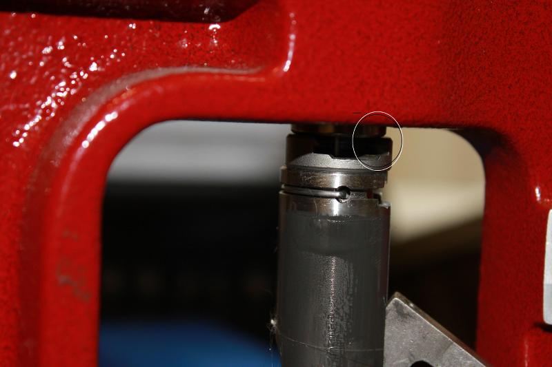

EXAMPLE
This is the die and shell holder just barely touching on a full stroke and "cam over" on a "O" style press
This is that same set up when sizing a 308 case .
Note the gap between the die and shell holder in the second pic that is not there in the first pic . This is do to press and linkage deflection/flex . You will get this happening even more with open face "C" type presses and even more with the Lee press you have . That gap in the second pic IMHO is why you are not seeing a bump in your shoulders . The press is flexing upward to much and you likely have room to screw it down farther even though the die and shell holder are touching when not sizing a case . If you run out of threads for your locking ring/nut on top you can use it on the bottom as well .
If you have your die set down more than needed for just kiss contact with the shell holder, enough so it will grip a sheet of thin paper hard when fully stops on the shellholder, then run a correctly lubed case in to the die. If then, there is a separation between shellholder and die bottom like in the earlier picture, the press just isn't up to the job & you'll need to get an O style press preferably, or a solid C press (though the latter is sending good money after bad)
