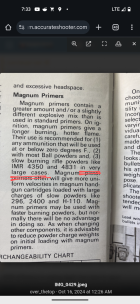

Edit: By the way, you're not comprehending what that picture from the reloading manual says about magnum primers and 4350 as well. The key words are at the end of the statement.

The load manual explanation about slow burning powder and mag primers is what it says, they recommend it. I use them over standard primers and it improved accuracy quite a bit, it tightened up my groups. You don't try it you'll never know, maybe certain primers over others will perform better. Rem 9 1/2 burn hotter than most. I use mags and have success. You're right, it doesn't matter to me.... the only thing that matters is other people agree with you and it makes you feel good, I guess. Although it doesn't seem they have the experience that's needed to guide you along. Not saying all of them but most of them don't.
Even after I pointed out what you missed about the magnum primers, you still didn't go back and look at it. What it says doesn't apply to a 6.5 Creedmoor.
