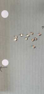

First example is nosler ABLR.... notoriously hard to tune but the price was right i wanted to try them. I always start with a pressure ladder to see how they generally shoot and to find my max safe charge.
Wide and spread out..... very bad.

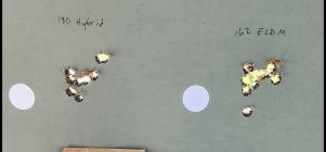

Next is same rifle with 180 hybrids and 162 ELDM.... bullets notoriously easy to tune....
Much more clumped together.... much better chance of finding an easy to shoot load.

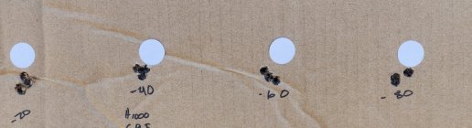

-40 did in fact shoot the smallest, but again impact are all pretty much same spot in relation to dot. This is a hunting rifle.... I'm very satisfied with the result.
White dot is 0.75. I use center dot scopes and I like uncluttered targets....I can't shoot targets with grid marks all over them as well as a plain dot.

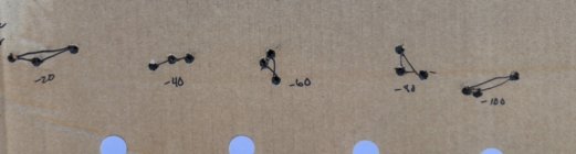

Next is a pretty typical average hunting rifle.
Groups for me usually show wide and then tall and then wide again as you change charge or seating depth.
I like seeing triangles.
So in this rifle -60 to -80 appears to be where it will shoot the smallest....
