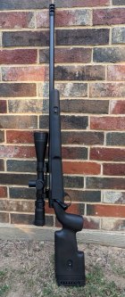

Yes sir. I was happy with the way it shot, first rattle out of the box. I did put a Choate Tactical stock on it and skim bedded it before I ever fired a shot.
