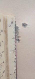

Got these out last night with the eld vt running 3620fps. Bad shots bad fur good shots great fur. Hits hard!

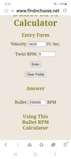

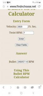

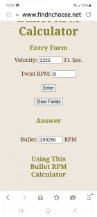

^^^How many revolutions does the bullet make from muzzle to target at 100 yards?
What is the rotational velocity of projectile in fps?

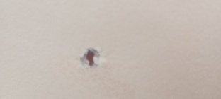

I ended up taking a coyote at 80 yards yesterday. Hit him in the chest (he was quartering away a little) and got a pretty good sized exit wound. He piled up about 10yards from were I shot him.
