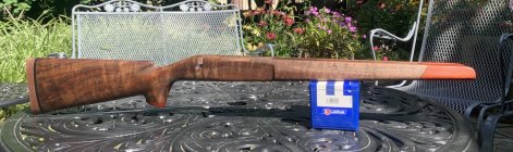

Here’s one I finished today. Sanded to 1000 grit, I left the precious dust in the pores and put a heavy coat of oil on it. I use my finger to apply it. A finger acts like a squeegee and pushes the slurry into the pores. A cloth would soak up the slurry. I’ll let it dry, then hand sand the stock with 1500 grit before another coat of oil.IMG_1743.jpegIMG_1742.jpeg
That's amazing!!!!! What oil you using?
Arrow wood finish. I’ve used a bunch of different oils over the years. Arrow can give you a high gloss finish if you want that.

I’d have to search thru it and I’ve refined my method since then. Also, I used Watco Danish Oil back then. It’s good stuff but I use Arrow Wood Finish oil, almost exclusively now.
In a nutshell, sand the stock to 1000 grit, using a good palm sander. Get the “hard to reach” areas by hand. Leave the sanding dust on the stock from 600, 800 and 1000. The process of sanding will pack the dust in the pores. After 1000, give the stock a “soaking” coat of oil, rubbed in by hand. Don’t use a cloth, paper towel or anything else, just your hand. Let it dry well, then lightly sand with 1200, 1500, 2000, etc. to your taste and time.
The stock I just did got it’s second coat of oil this morning. I’ll let it dry for two or three days before giving it more coats. The first heavy coat soaks in deep and takes a while to really dry.
The Arrow will give you a glossy finish at 1200, but I’ve gone up to 2500 on some, during those long winter days.

@joshb I have arrow oil on hand. Do you just use your fingers and apply heavily and rub it in? Then whatever grit you sand after it dries determines the sheen? Glossy or satin?
How many coats do you typically apply? Apply thinner coats as the more coats you apply?
First coat is the heavy coat. Use our fingers for all coats. The ability to get a high gloss depends on how fine you sand it BEFORE you apply any oil. Reread my instructions above. Second , third, etc. coats should be very thin. Read the Arrow oil instructions and follow them.
