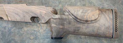

I think I'm done with the rollover area. Started sanding with 220 just to see where I was at with rough spots. Probably have to go back to 120. What are these black lines? Something I need to sand out?
Also, thoughts on the size of the grip cap? Smaller/thinner?
And the tip of the stock? Barrel channel isnt fully sanded yet but it's only a Sporter barrel.
I know there isn't a definite answer to this question, but how much rough sanding should I be doing? Hours and hours? More time with 220 or 320? Just curious really. I know it depends on stock condition as to how much sanding is required but rough idea?
If you have already sanded to 220 and gotten rid of the sanding scratches, don't go back to 120. You'll just make more work and may even remove too much wood when all done.
The black lines are probably just black lines in the wood that occur, don't worry about them.
Does the grip cap fit your hand? Adjust from there but i think it looks fine. Sand the tip and grip cap as you sand the rest but watch the edges that you don't round them over. This stock looks like they are meant to have some shape and not look melted.
Rough sanding takes the longest and can be done with a random orbital. You can take a damp paper towel and gently wipe the stock to see if any low spots don't get wet or run the palm of your hand over to find low spots.
As you go up in grit, you'll spend less time with each grit. You'll know know when you get the sanding scratches out and can move up a grit.
Wet the wood at 220 and sand off the whiskers with 320 and see how it looks. Use compressed air to blow out the grain frequently.
If you need, to experiment on a scrap piece of walnut, carved into a rounded shape, then move back to the stock.
Back at it some more today. Wanted a sharper rollover so got out the Dremel and worked on it. Pretty happy with it now, needs a little more edge towards the back curve.
Decided to just sand the grip cap flat, wasn't fond of the rounded look. Needs more but working on it.
One question, anyone know what these black spots are? There's this one and a smaller one on the top of the butt end.

Ready to start 220/320 sanding. Then working on the inlet for barrel and action.
Got the rollover to where I want, I think :). Grip cap too, got it parallel to spacer and flat. Fore end is still up in the air. Feels as though it has a small dip but it fits my hand nicely.
Thoughts? I wiped it down with some thinner, hence the darker areas.
Well, I dropped the barreled action in and it fits pretty well actually. Need to sand some area away so safety works fully and some below bolt release works freely. Minor.
But did find there's about a 1/16" of stock below the bottom metal, so will have to sand that down till flush.
And biggest concern is the fore end. Looks way to long and big. Guess I'll have to round it off a bunch. Dremel time!
