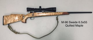

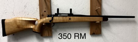

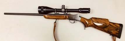

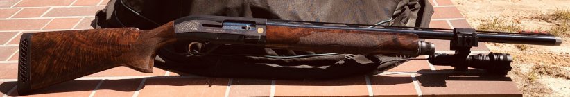

These are examples of some of my wood stocks. Different styles and actions.

I have used Tru-Oil 4ish times. It did give me a good final finish and I did not mind the process. The one I liked the best was my first and it also cost the most so I was very careful. It is a 1885 C Sharps Highwall with a higher grade of walnut. I don't remember how many coats I did but I filled the grain and made it glass smooth. Naturally it shows every little scratch it has recieved. I would do it again though.
