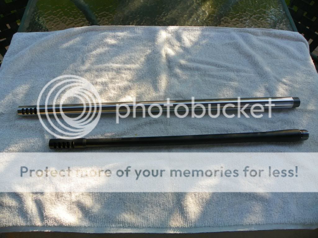

I put it in the lathe and turned the chamber end to 1.250 Dia. and then turned it around and put it between centers and offset the tailstock to get the muzzle down to 1.100 Dia. Never having to do something like that before I kept getting chatter after getting about 4 inches into the cut. I tried all sorts of different carbide inserts, even grinding different tips and profiles on them. I finally switched to a tool steel bit and had a lot better success. After 2 passes, which would take 15 min a pass, I would take the barrel out and cool it with water and regrind the tool bit. I was going .010 deep and .004 a rev. So to malke a long story short it took me over 7 hours to get it finished.
I then made a muzzle brake ( just like one of the most effective brakes going ) and installed it ( I know brakes aren't allowed in F class competition, but where I shoot the Gentleman that runs it says just bring what you have and come out and have a good time. I like to just punch paper a lot so the brake makes it kick like a 223. I am going to make a sleeve to cover it if I decide to compete some where else. ) and then threaded and chambered it. The chambering went fairly easy at first but once I got about halfway it got really hard, only taking .010 and then cleaning and relubing like the Vipers video showed. I don't know if it was because the barrel was used, but I heard a KEEK at about .250 left to chamber and then found out I had cracked 3 flutes on the reamer just at the shoulder junction. So I took it out of the floating reamer holder and got the tapping handle and tried it by hand. I would turn the handle and push and after 10 turns I took it out and cleaned the chips and after doing that 3 times I would measure my progress and it would be between .007 and .010 SO 2.5 hours later the bolt closed on my gauge.
I took the barrel to a place here in Phoenix that does Melonite, just like MMI Tru tech ( salt bath nitriding, supposed to double barrel life ) and it was finished the next day, it had a nice satin black finish that felt really smoth and hard. It took an hour to clean it out really good with some JB and then some Bore tech.

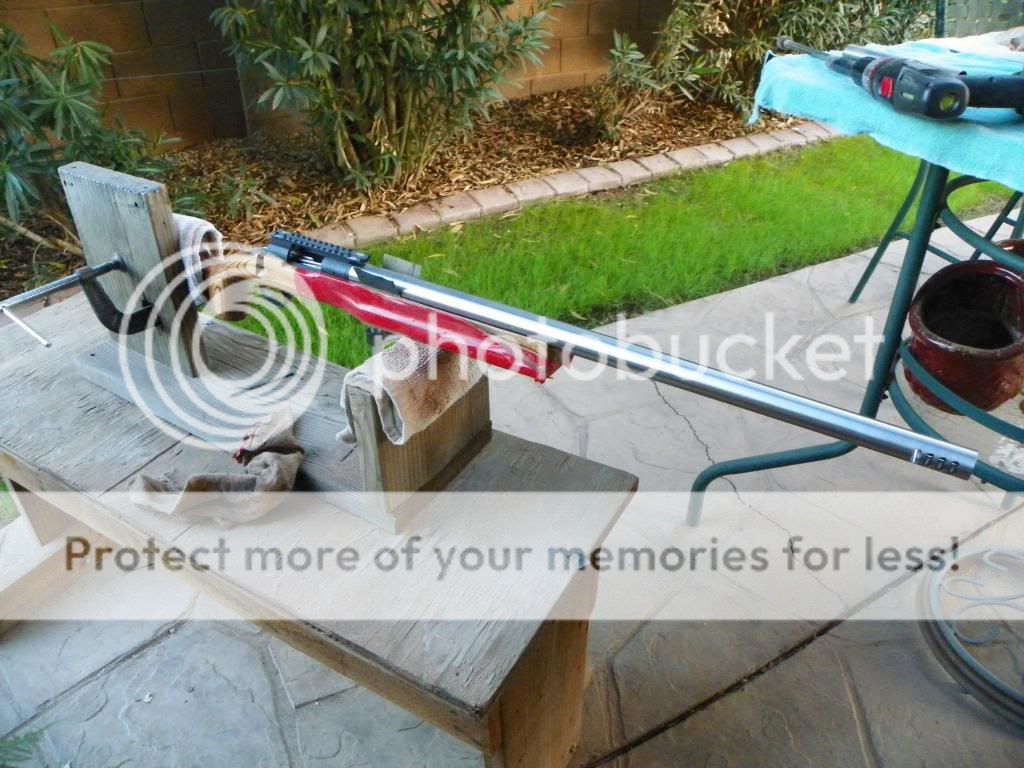

Fitting the barrel in the Bobby Hart LRT stock and Devcon bedding including 6 in. of the barrel which is straight 1.250.

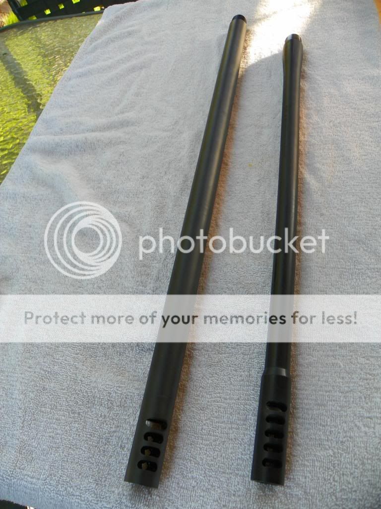

Barrel before Melonite next to the factory 5R barrel
Barrel after Melonite

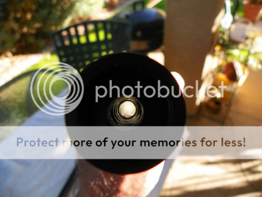

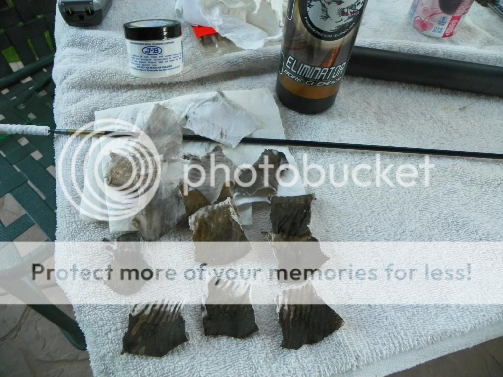

The bore is a little dirty from the salt bath.
This is what it took to clean it

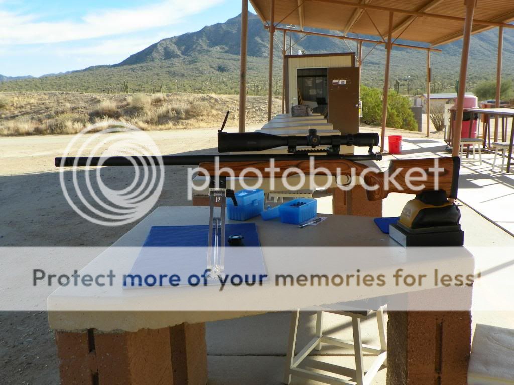

This is the finished project.
Rem. 700 Faced and lugs trued, firing pin bushed and turned to .060, EGW 20 MOA base, Burris Black Diamond 6x-24x and Burris XTR rings. Shilen 2 oz benchrest trigger, Bobby Hart LRT stock. Bipod made by me and I have some to sell, will try to post some pics tomorrow. That is my 6.5 WSM that I built in the backround with the stainless barrel.

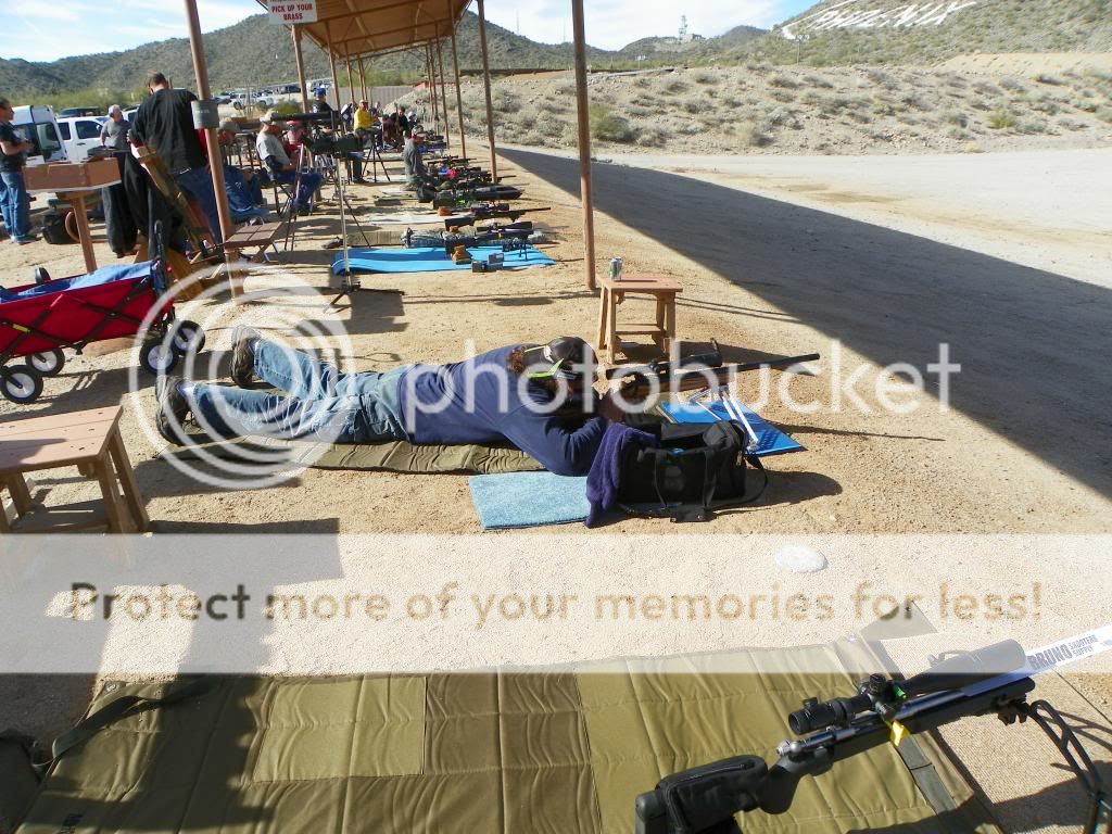

And that is me at the match.
