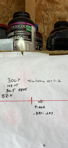

For a couple of years now I have been shooting our 600 yards benchrest matches (groundhog targets), with wind flags. A bit of an stretch for the 90 grains, but knowing that our range is kind of protected, I gave it a shot literally.
And it has not disappointed.
This is I think my best target so far, one shot a bit high, the other 9’s well grouped.
It is by no means the best bullet at this distance, but under mild conditions it can work.

I am curious after looking at the target you posted. What do you believe kept it from being better? I'm sure you're aware of group shapes and wind. Meaning, there is a clear up and to the right diagonal shape to that group. Of course it can be your hold so I can't assume anything but with or without flags, there's no wind condition that will do that from a rh twist bbl. Just curious if you have any thoughts in regard to that.
Not sure about the vertical in the group, most likely at near the gun’s limit plus my lack of table manners, and some (though minimal) updrafts.
I would not read much on the windage, as I was favoring right to protect the left edge of the target, my goal was to shoot center or center/right due to the predominant R to L wind.
Thank you! It's hard to read group shape when shooting for score too. No telling where the shooter is holding, so hard to tell much with that being the case. Even being relatively small, I'd lean toward it being a little out of tune but like I said, hard to know
