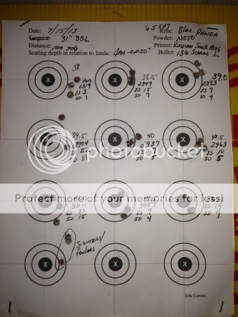

Erik Cortina said:
My turn! ;)
6.5 x 47 Lapua
31" Krieger 4 groove
N550 Powder
Wolf small rifle magnum primers
Lapua 136 gr. Scenar L
Powder test from 38.0 gr. to 42.0 grains VV N550. What do you guys think?
i think 38.5
speed is there and groups left and right look good, seating depth is next,
Erik where are you?
Well, I picked 40.2 gr. groups were very close vertically and with good ES. When I shot this test, I was getting some hang fires with the Wolf primers. When I tested seating depth, I was able to tighten the groups at .-016" but was still having hang fires so I had to change primers and start again.
I will post pictures of the seating depth test later.
40.5 with regards to Erik's. ***i posted this before Erik's post but it shows after his post? I think my time and 6mm's time are off a bit?
