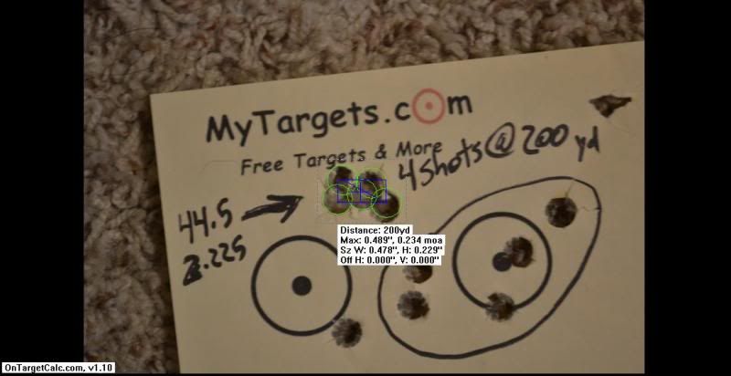

finally took the load I worked up at 100 and final tuned it/verified it at 200 yards. The group was shot off bipod with 308win
The group to the right was different seating depth
Did final testing before my match at 100 yards. I tested 54.8gn of H4831SC with bullets at a soft seat and also at -.012 " which were the two depths that gave the best results. My brass is on its second firing with less than .001 runout and I am running fed 210 primers. I was hoping for a lower ES. I know my powder charges are very consistent with my digital scale, primer pockets uniformed and brass length is equal amongst pieces as was the seating depth measured at the ogive. I also bump my shoulders .001 - .0015 each loading. Not sure what else to do to get into single digits other than weigh/sort my brass which I will do for my match. Any suggestions?

Lawrence97, I think you'll be ok. Your ES is a little high, but if you notice it gets higher as the string gets longer. I have seen this before and I think it's normal and you can definetly click your scope down during a record string if you notice you are climbing on target. Take load out to a match and have fun.
